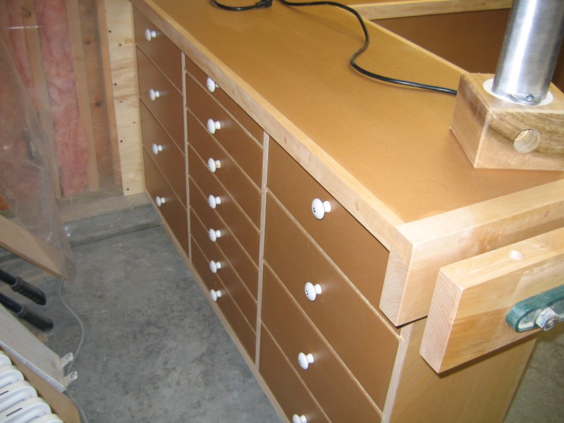

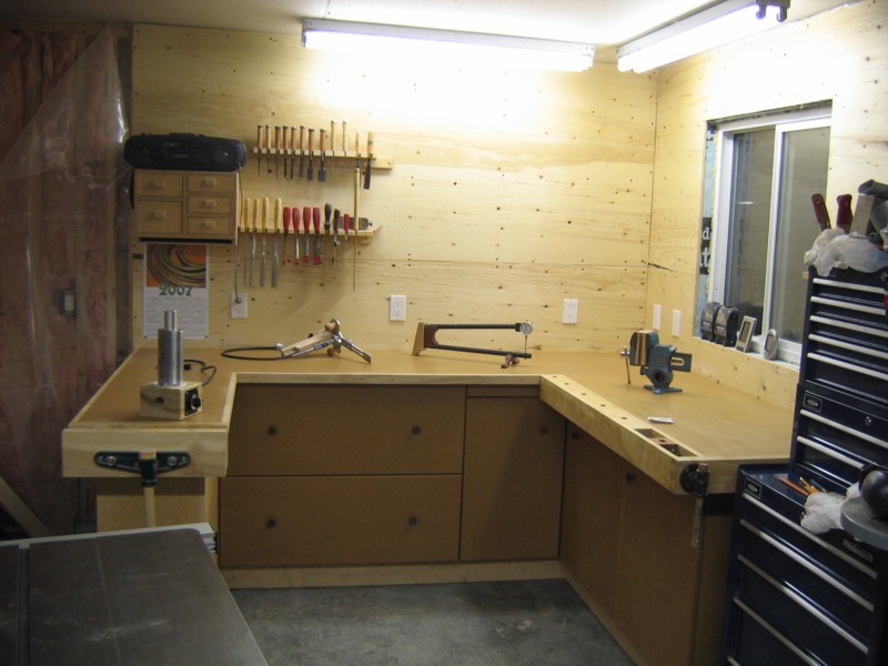

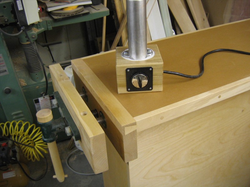

Filippo,
I made a bench this past winter specifically for guitar building. My design criteria were LOTS of storage, sturdy, lots of bench space and relatively inexpensive. It is constructed much like kitchen cabinets, in that the base is three seperate cabinets and the top is made as one piece and screwed in place from below. The top is two layers of 3/4 inch MDF, capped with 3/4 inch x 1 1/2 inch birch except for where the vises are. The top overhangs 2 inches all around so that I have good clamping surfaces. I have a bench dog system on the east side (our right in the picture) and a tail vise on the west. I have a parrot vise and a small swivel vise that I mounted on bases that I clamp into the tail vise when I need them. I have redone the chisel holders (and added a few more chisels) and have filled the wall space with other cabinets and fixtures to hold tools and jigs. I post these just as food for thought. Oh ya, the top on the tail vise end is only 18 inches wide, I got this idea from looking at Luthier benches where it was mentioned a couple of times that this allows access to the guitar from two sides without having to move it around. I actually quite enjoy this narrower wing and find that is where I spend most of my time.
Good luck!
PostPosted: Sun Apr 01, 2007 7:09 pm
Shane, I like your setup! I am planning to build something similar in my new shop.
I haven't read every post in this thread carefully, but the traditional woodworking bench that Todd showed pictures of is great for planing, in fact we call them "hovelbenk" (=planing bench) up here. I have 2 of these in my shop.   What makes them good for this are the vises, the mass and sturdy base, the bench top and the right height. This height is too low for detail work IMO, so it is a good idea to either have benches at different heights for different tasks, possibly an adjustable base like Filippo mentions in his first post.
